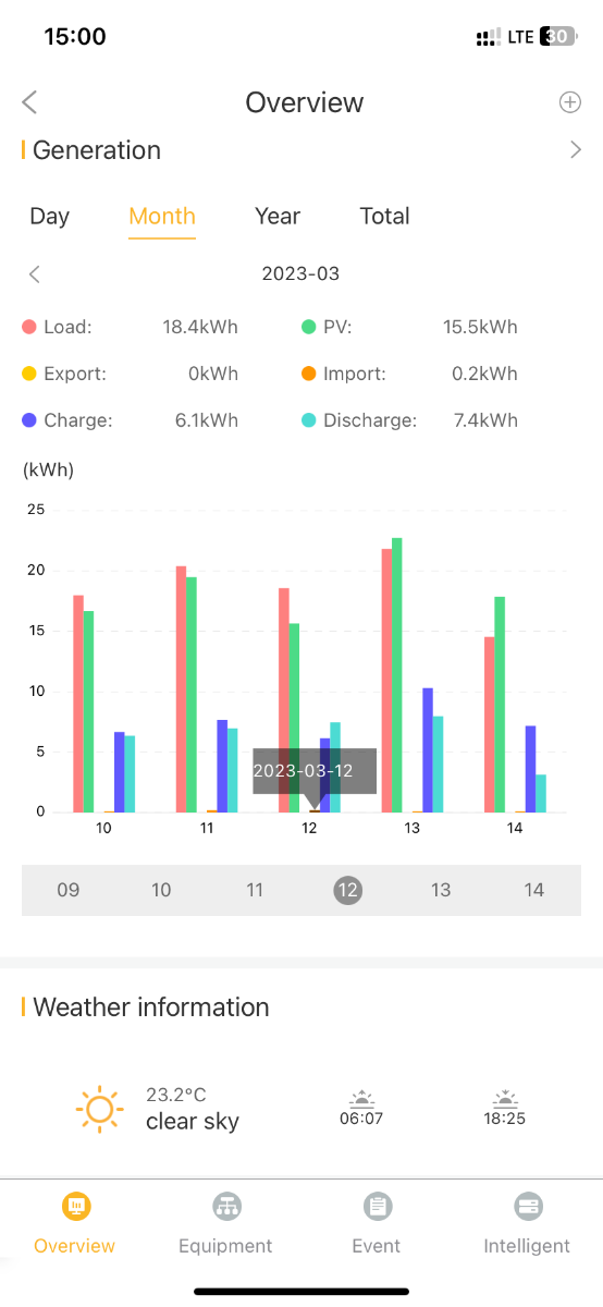

Loving the zero Eskom import the last 3 days since my upgrade...ZeroImport.JPG.4d724099a464ecd1328a3740c39ac8ed.JPG
Also busy with intergrating the inveter sensors to HA now that I've found a solution to pulling in the sensor data so I can use it as parameters for my other smart devices like my geyser switch.  Ultimatly want to drop the geyser on essential supply and just set some parameters to ensure if it is loadshedding and there is enough SOC and PV the geyser can be turned on despite it being loadshedding and only if it is a 💩 day and the SOC and PV is to low wait for Eskom before turning it one...
What's your grid trickle feed setting? Installer told me to keep it at 30, so I'll never have zero import, unless there's loadshedding/outage
I set mine to 0 as it was at 20w.  I asked the installer why and the reason was primarily if you have a Pre Paid meter it helps prevent the thing going into tamper mode so they tend to just set it at 20w by default.  Seeing as I don't have one we just set it to 0 as a test and well it works for me. I have not had an issue with it set to 0.  No trickle feed nor feedback to grid as it set to Zero Export.
As you stated if that is set to anything more than 0 you will never have Zero Export.  20w would mean 14units per month minimum on my account.
I'm at that point that if Eskom can't provide constant power why should I pay them anything for nothing 🤷‍♂️

I have a "normal meter" with zero export selected, but installer reckons he doesn't trust the settings so we err on the side of caution. But I'm going to lower my trickle to 20 to see what happens.
Our municipality charges me a connection fee irrespective of my usage, but in any case still use some eksdom, as I run a higher SOC at night just in case and my aircon goes through units like its free, but it's summer and its hot and I like sleep.
Yes that last little piece of pie crumb one can't get rid off.  A connection fee to a broken network...😔
You can try 10 as well think that is the lowest you can set it via the touch screen or test it for a day at 0 perhaps.  Only saw one little blimp of a feedback 0.06 in the last 4 days (had those random feedback's even with trickle feed set at 20 🤷‍♂️)
Side note I'm now running Priority load 99% of the time.  When in Priority load the inverter seems to run off solar and battery at night if on Battery Priority the inverter runs on "solar" in the day if there is excess available and AC power at night.  My personal observation and deduction.
Mine is set to 10W
That setting shouldn't make a difference to what it runs on at night. Mine is set on Priority Battery and runs on solar during the day and the battery at night until I get down to the specified SOC. My guess is that you have the SOC settings too high overnight or you are not using the timer.
Yes you you are correct in my SOC was high.  This was when I was still "locking out" my battery during peak time to save max capacity for evening loadshedding and running on battery from 02:00-sunrise.
What I basicaly noticed was if I was at 100% SOC and in battery priority mode everything ran of AC but if I was in Priority load and the SOC was 100% the inverter would drain at about 1% per hour so at 2:00 I would end up at like 92% eventhough the SOC was set at 100% which led me to make the assumption that the inverter is powered from the battery if in priority load mode vs if it is in battery priority as the SOC will not drop untill I started using it during loadshedding 🤷‍♂️.
