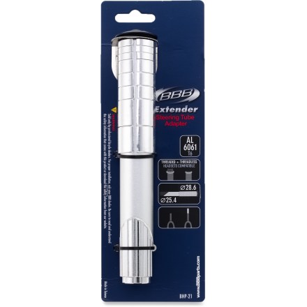

  22. Heres the BBB one the part number is BHP 21 and is available in SA if you can't find one let me know and I'll try to get hold of one for you. Its called an Extender (Steerer Tube Adaptor)

  24. Use an the old threaded heaset and get an adaptor I think BBB makes them or if the 1" headset is threadless simply use a space inside the 1 1/8" stem.
