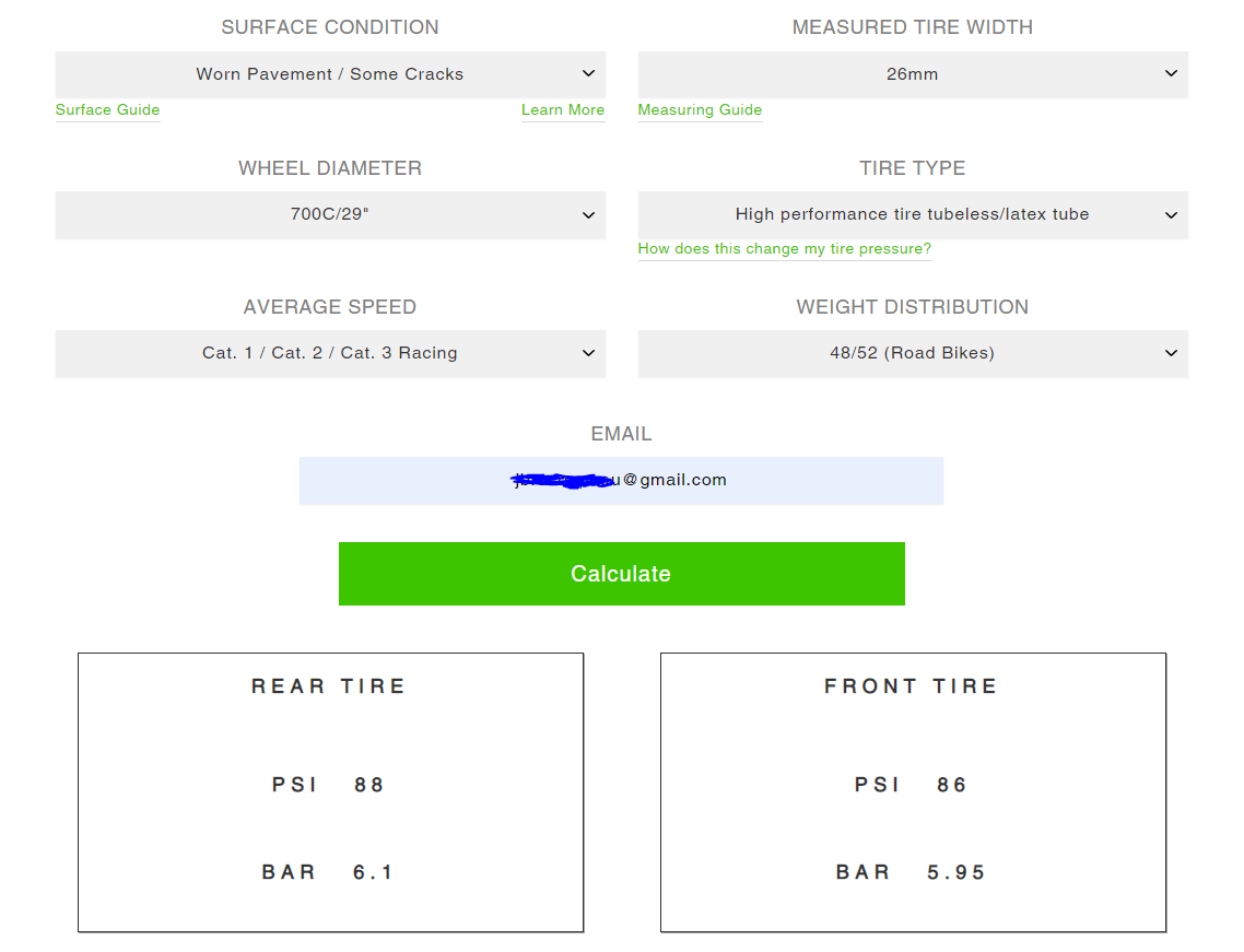

Jbr Posted November 6, 2022 Share 1 minute ago, 100Tours said: Interesting - I'm running my front (GP5000 TL 25mm) at 5 bar on a tandem, so 6 seems high. The rear runs at 7 bar and isn't tubeless because I have found it starts giving issues at this pressure. https://silca.cc/pages/sppc-form DieselnDust 1 Link to comment Share on other sites More sharing options...
100Tours Posted November 6, 2022 Share 19 minutes ago, Jbr said: https://silca.cc/pages/sppc-form interesting - weight distribution on the big bike is probably more like 60:40, and I have no idea how to class Joburg's roads (poor pavement/chipseal?), but I'm running tubeless up front to deal partly with snakebite risk on road holes. So silca.cc is about 0.5bar above where I'm running them for both tyres Edited November 6, 2022 by 100Tours Link to comment Share on other sites More sharing options...

Furbz Posted November 7, 2022 Share 10 hours ago, Jbr said: https://silca.cc/pages/sppc-form Not sure i like this link... it totally omits the rims inner width which has a huge impact on tire volume. gave me figures for 28mm higher than max inflation figures for my zipp wheels. i'd rather use the zipp calculator - seems more comprehensive 100Tours, W@nted and DieselnDust 3 Link to comment Share on other sites More sharing options...
Jbr Posted November 7, 2022 Share 43 minutes ago, Furbz said: Not sure i like this link... it totally omits the rims inner width which has a huge impact on tire volume. gave me figures for 28mm higher than max inflation figures for my zipp wheels. i'd rather use the zipp calculator - seems more comprehensive I think measured width is supposed to take care of that. What is the recommendation that you get ? I find it surprising as I used to pump my tires up to 7 bars and only started doing 6 bars after I saw Silca's recommendations (I must say I've had a lot less sealant showers since then as well) Edited November 7, 2022 by Jbr Link to comment Share on other sites More sharing options...
DieselnDust Posted November 7, 2022 Share 11 hours ago, Jbr said: https://silca.cc/pages/sppc-form There’s something wrong with this calculator. It’s slots out crazy low pressure for Mtb and too high for road. I agree with Furnz the zipp calculator aligns closer to my real world experiences Edited November 7, 2022 by DieselnDust Link to comment Share on other sites More sharing options...
Jbr Posted November 7, 2022 Share 4 minutes ago, DieselnDust said: There’s something wrong with this calculator. It’s slots out crazy low pressure Still seems pretty good to me, at least that's +/- what I use as I tend to aim for 6 bars Edited November 7, 2022 by Jbr Akon 1 Link to comment Share on other sites More sharing options...
DieselnDust Posted November 7, 2022 Share That’s the exact same result I get for a 26mm tyre but I’m running 75psi rear and 70psi front. i used 82kg for bike +rider+gear. dt Swiss max recommendation for the spline 1400 wheel is 96psi. Yet they have a rider weight limit of 100kg!!!??? st the end of the day these tools spit out recommendations. I hit a railway line hard yesterday and didn’t damage the rim or tyre but the gsrmin broke off its mount. Tabs are still stuck in the mount. I didn’t damage the wheels so I’m inclined to believe the assumptions in the silca tool are heavily conservative Link to comment Share on other sites More sharing options...
