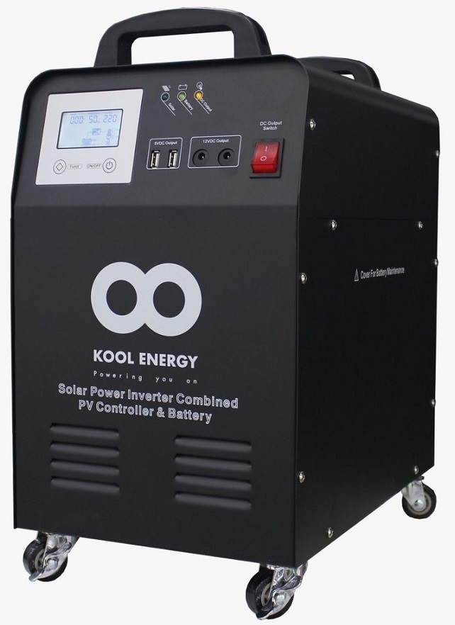

I see these popping up now, not sure on the quality. They go for about 9k
Kool Energy: Mobile Inverter Trolley 1KW 100AH 12V (Kool-MIT-1KW)
Kool Energy: Mobile Inverter Trolley 1KW 100AH 12V (Kool-MIT-1KW) - Solar  Europe
This may look tempting .... some of the good points:
1. Affordable
2. Easy install and use
3. Pure sine wave (at least claimed)
4. Solar input .... though this DO open a big can of worms and a host of a legal issues ......
DOWN SIDES :
1. Looks like it can only fit one battery ... no way to expand WHEN your needs increase ....
2. 10A charge is TOO SLOW for higher loadshedding shedules !!!  This system simply cant recharge fast enough, and will damage the battery all too soon (during higher loadshedding periods) .....
3. Seems like a normal lead acid battery, thus the low charge rate.  (at the very least you want a gel battery and a 15A charger, and even this struggles past Stage 4 loadshedding!!)
rather save a bit more .... die is goedkoop koop is duur koop ....
