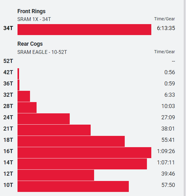

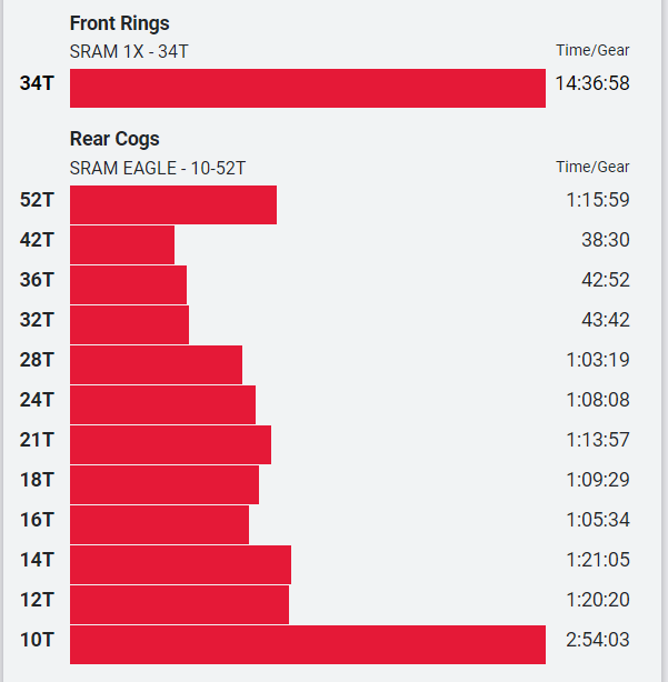

My suggestion would always be to see if you can get an AXS shifter. Then you can ride a bit and adjust the front chainring as and when you need it. The AXS gives you the time and distance spent in each gear in your drivetrain allowing you to make data based decisions. Soon you will understand what you need for certain situations...
For example my 34t chainring needs to be changed for a 36t for shorter rides in and around our area. As below you can see I don't touch granny gear.
This was 125km gravel ride on mtb from home so fairly flat.
But when it gets a bit more elevation gain and bigger distance(250km) then the 34t is perfect as below:
