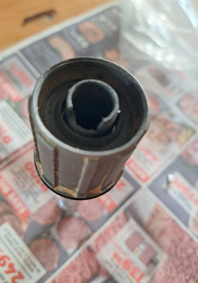

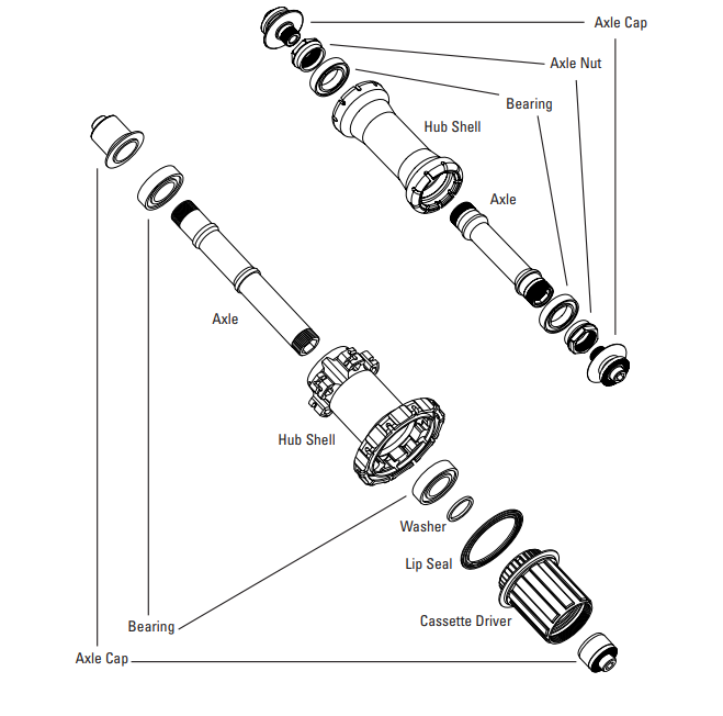

On 10/3/2025 at 1:37 PM, Shebeen said:
Hail mary here.
my free hub went over the weekend, opened up to find a broken pawl, (found a new one).
BUT, the axle thread on the drive side is cracked.
Have gone to LBS to find if they can order a spare from SRAM, but then whilst I wait on that wondered now if someone has something similar from a busted wheelset.
Hub is SRAM MTH 746 - wheelset is sun ringle inferno23. Off a RM vertex 2013. (non boost) TA12x148
only the axle is moertoe (although i do wonder how long it's been like this!!)
Try a Specialized store. I suspect those axles are the same as the in Formula hubs used on the Comp-level Spez wheels from the same era.
  • Replies 2.3k
8 hours ago, CARANXCycleMobile said:
Can you supply me with dimensions ( length inside and outside) plus diameter ? I should have something that will fit.
In hindsight, really should have got the vernier out when i had it all open. Will do.
hot tip, thanks Droo. It survived the Muratie Meurant ride, but this is a JRA waiting to happen
You can pull the axle out with the freehub on so you don't have to take the nut off the janky end, so at least there's that.
It's held in compression by the through axle, so the failure won't be catastrophic - but when it does go it'll break at the step between the freehub bearing end the spacer.

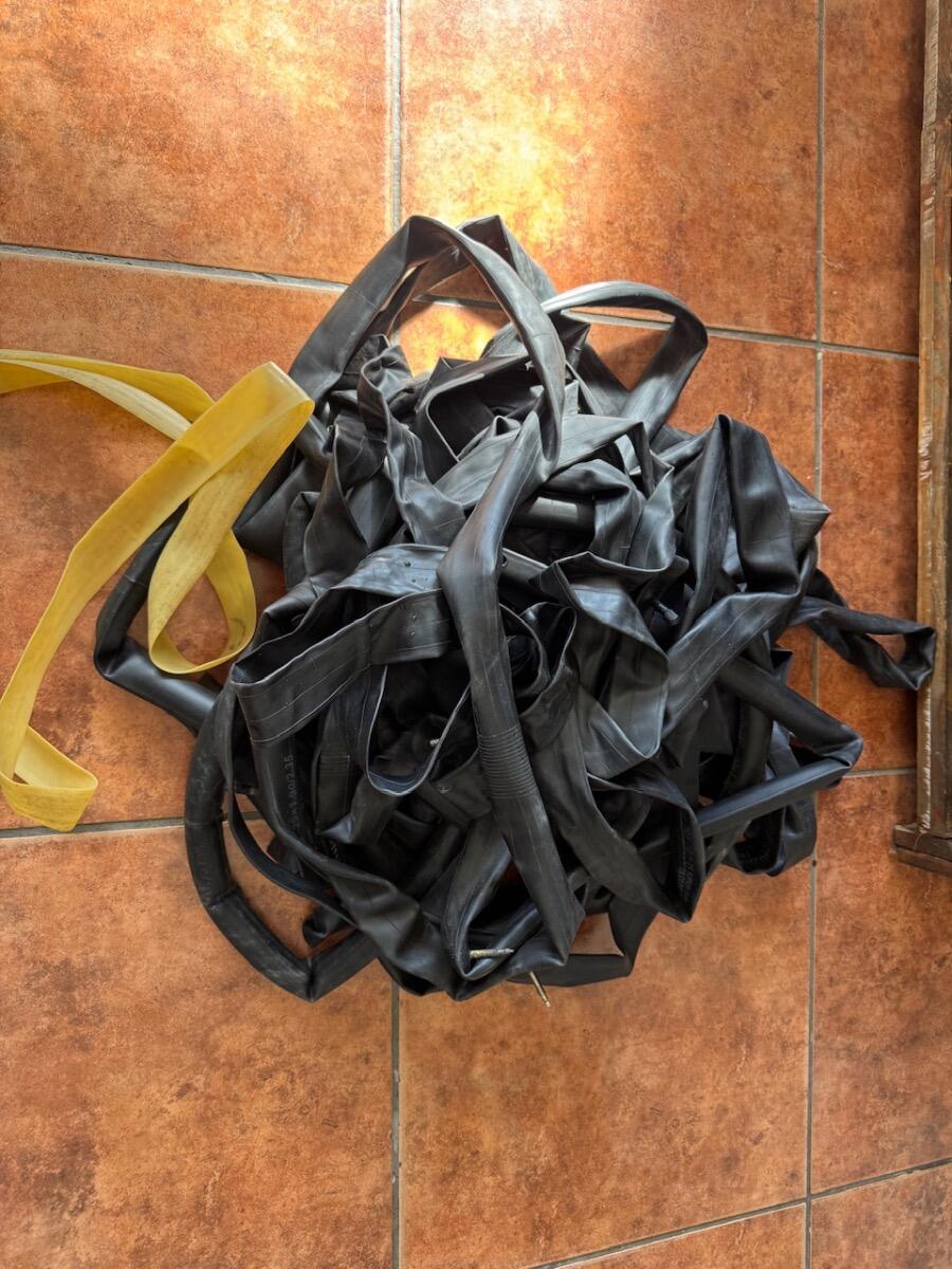

Bunch of old tubes that were removed from bikes to do tubeless conversions.
26/27.5 and 29.
Free to anyone that can make use of it.

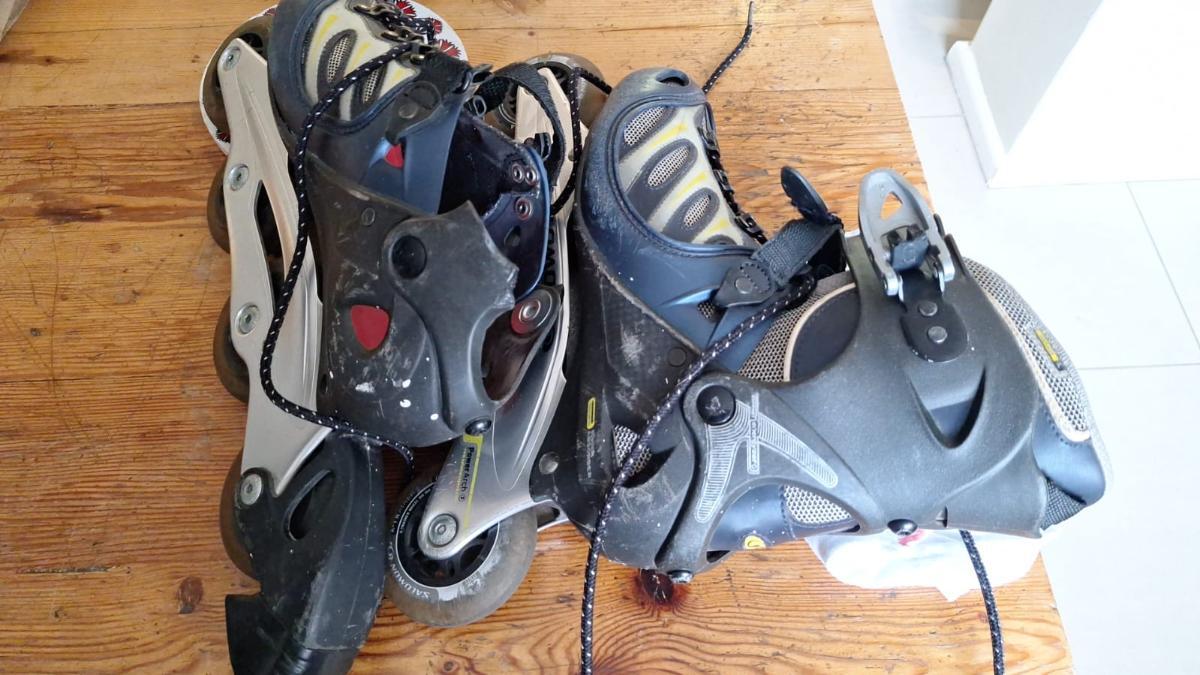

picked up these rollerblades for my daughter - Salomon is a decent brand, but the ankle cuff plastic is deteriorating to the point of destruction on one already.
SOOOOO, in the name of throwing good money and time after bad, looking at redoing them
like so.
https://www.instagram.com/p/CFqZtbkjUNg/?igsh=cTVrb3NmaGdxbzIx&fbclid=IwY2xjawNa965leHRuA2FlbQIxMABicmlkETF6TTlkNTZpNzJMM3pHdmxWAR6xPwc0UMIQpO4LbWpshjtoEnuvyTXBznsAmaWuOSYrQx6rMl2IRcT3GI_zHQ_aem_wQQCJgXbEwM3aR9v7bY8VA
therefore, wondering if anyone has a donor rollerblade that is sitting around, and i will hack the cuffs out of them - these are size 7 but there can be wiggle room. not entirely sure how I will do the rivets to keep them flush, but thinking a chainring bolt set with washers could work.
of course there is the bulletproof option.
No photo description available.
open to suggestions/FLAMES

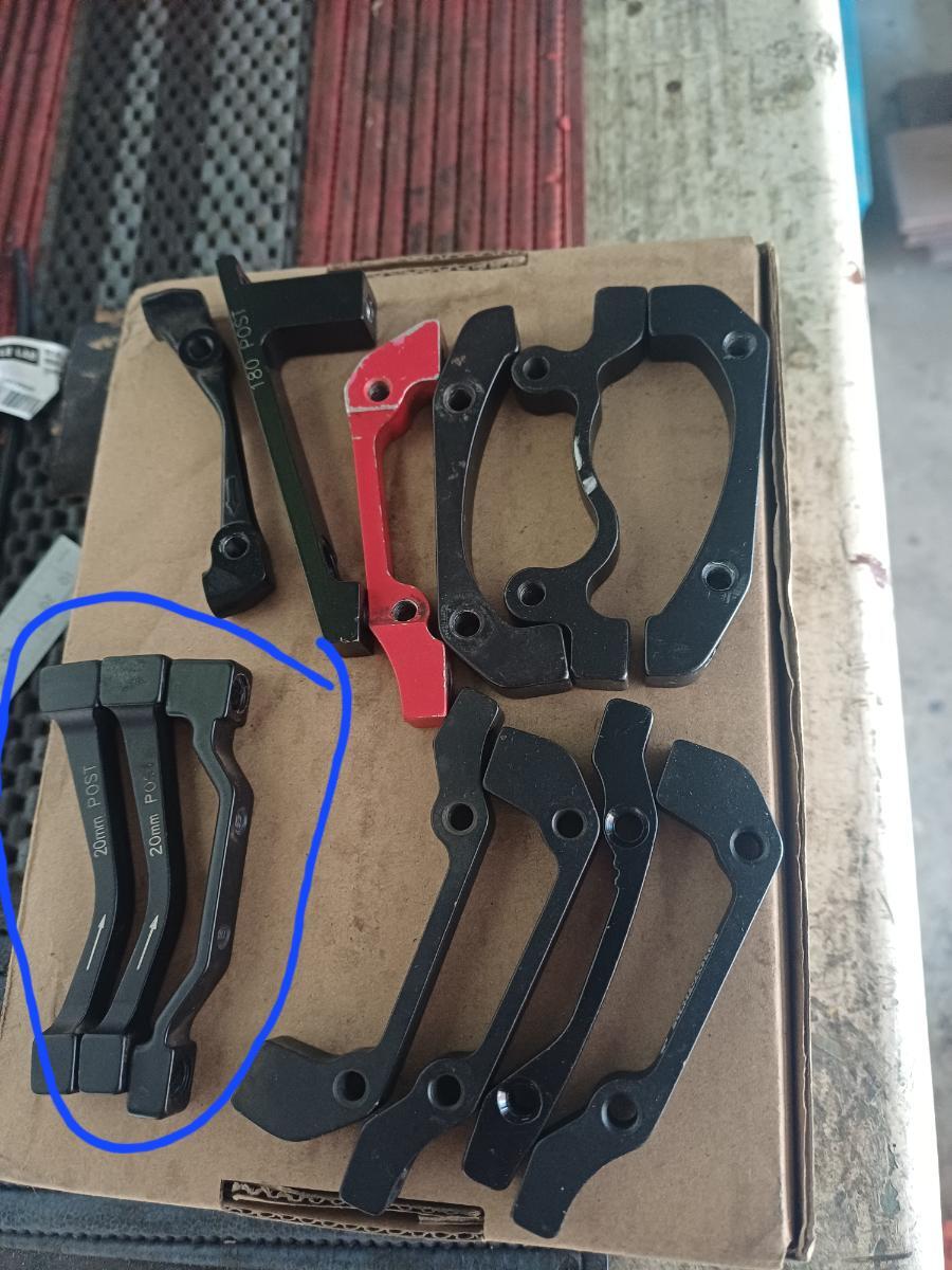

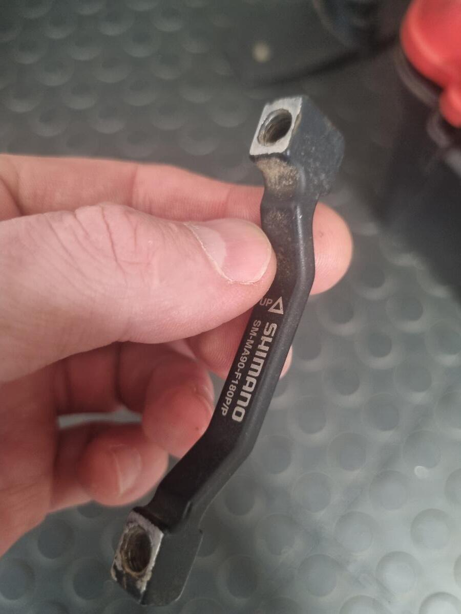

I need a 160 - 180mm post mount adapter please, yes I know the shop has but maybe someone has a few then I can bundle
will throw in some beer coupons or whatever you fancy 😁
Edited by RobertWhitehead
Added kiekie
57 minutes ago, RobertWhitehead said:
I need a 160 - 180mm rotor spacer please, will throw in some beer coupons or whatever you fancy 😁
For us dumb people.......
Rotor spacer?
1 hour ago, RobertWhitehead said:
Added a kiekie to the original post
Sorry.
Almost thought I could help but only saw now it post mount which is, in my box of spares, a bit of a rarity.
Hi Robert,
I have a few adapters for you. You can take the whole lot?  Send Philipie with some chocolate. 🍫
