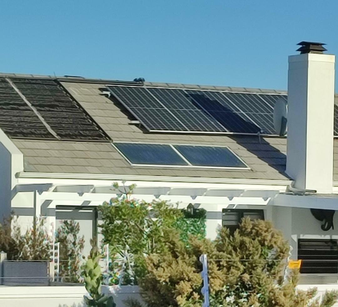

Where I live in Sunningdale these solar flat panel geysers are installed. This pic is of my neighbour. You can see the panels to the left of the chimney.
In the summer the thermostat in the garage displays the temp around 71°C and in winter it sometimes needs some electric subsidy to get it up to temp, but only when guests are visiting. The temp regulator on the geyser only permits the water to reach 53°C which is plenty hot enough.
