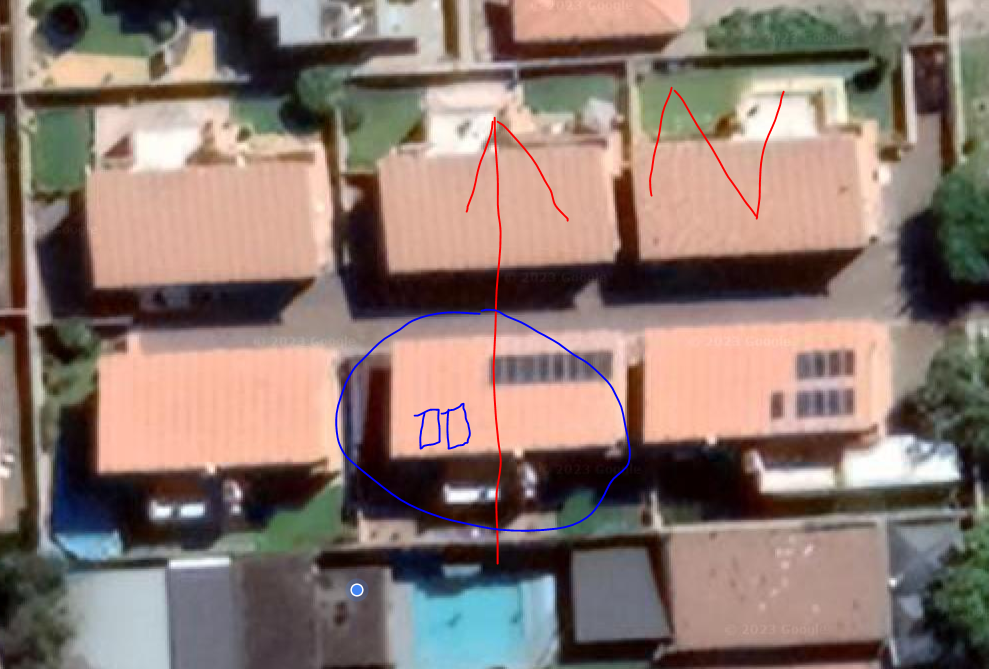

12 hours ago, Frosty said:
When you say they aren’t ideally placed, are they facing more than one direction?
Jip, the house is built NW to SW to have a nice view of our mountain, with the result that there is only a little bit of roof space facing north-ish. So we had to put the one string on the one section of roof facing slightly NW, and the second string facing more east as it was the only space available.
That’s similar to my place; running NW to SE. I also have it split on two sides. But that’s because I have a solar geyser and the pool heating equipment on the NE facing roof.
