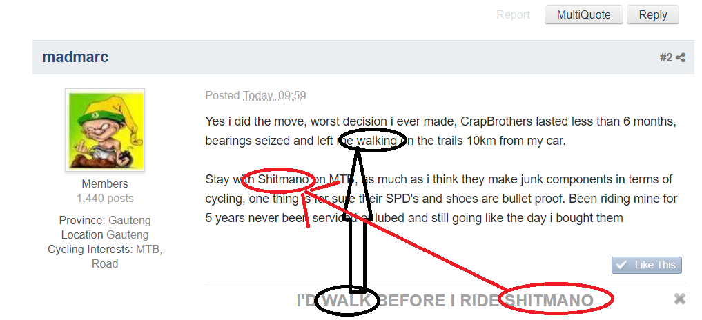

Yes i did the move, worst decision i ever made, CrapBrothers lasted less than 6 months, bearings seized and left me walking on the trails 10km from my car.
Stay with Shitmano on MTB, as much as i think they make junk components in terms of cycling, one thing is for sure their SPD's and shoes are bullet proof. Been riding mine for 5 years never been serviced or lubed and still going like the day i bought them
LOL!!!!!
"I'D WALK BEFORE I RIDE SHITMANO"
(Thanks for your input)
even though you said it straight out, this is still funny!post-1830-0-44589400-1542096615_thumb.png
