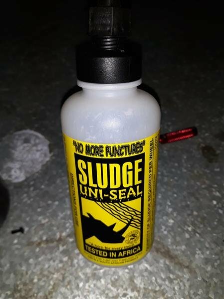

About 5 years ago my LBS recommended "Uni-seal SLUDGE"
Thousands of kilometers later, and many many thorns later, we are HAPPY with this product.
It works equally well in tubeless, as well as in tubes.  Used it in Maritz's bikes for years when we could not do tubeless conversions to his smaller bikes.  I now also use it on the tubes with my 50C tires, as these tires are not tubeless ready.... I have seen the post ride evidence of white droplets on the downtube of a puncture that got sealed without interupting my ride.

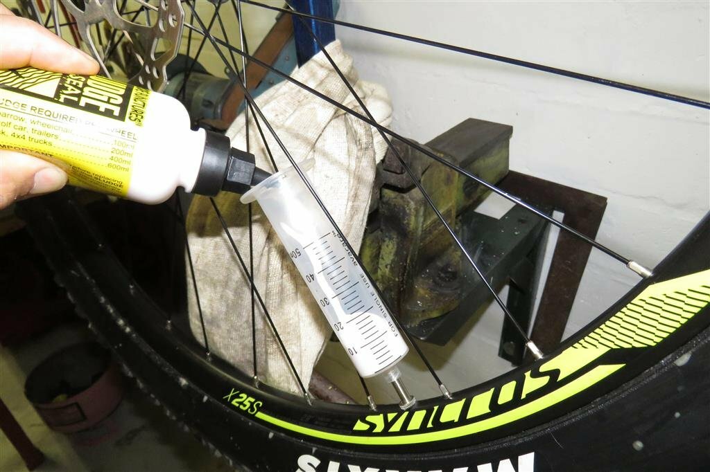

I also first seat the the tires, get the job done, then add the sealant via the valve.  Top-ups are done this way.  Maybe 2 minutes per tire.  Clean.  Easy, no hassles.
