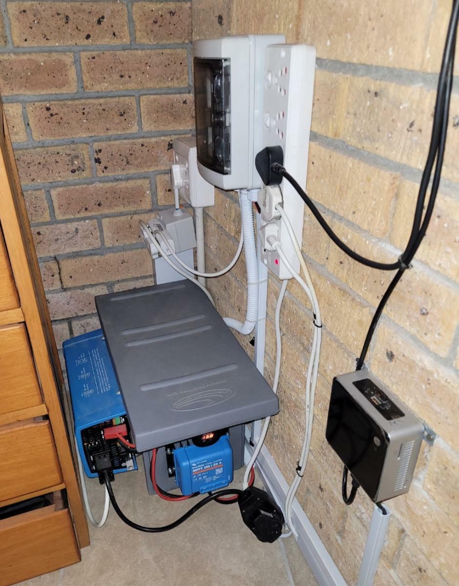

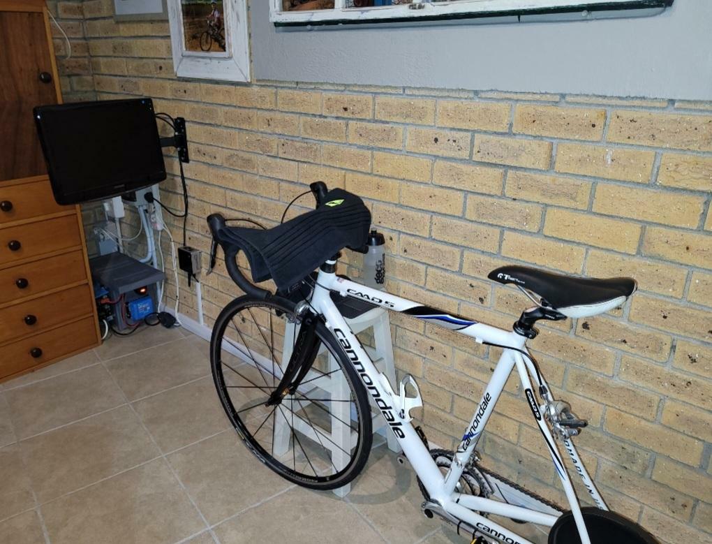

Extending the capacity of my UPS battery box for those long day time loadsheds.  (Using panels already approved by a NERSA application)
And YES, it is cycling related 👍
Even cleaned up the cable layout for the IDT
