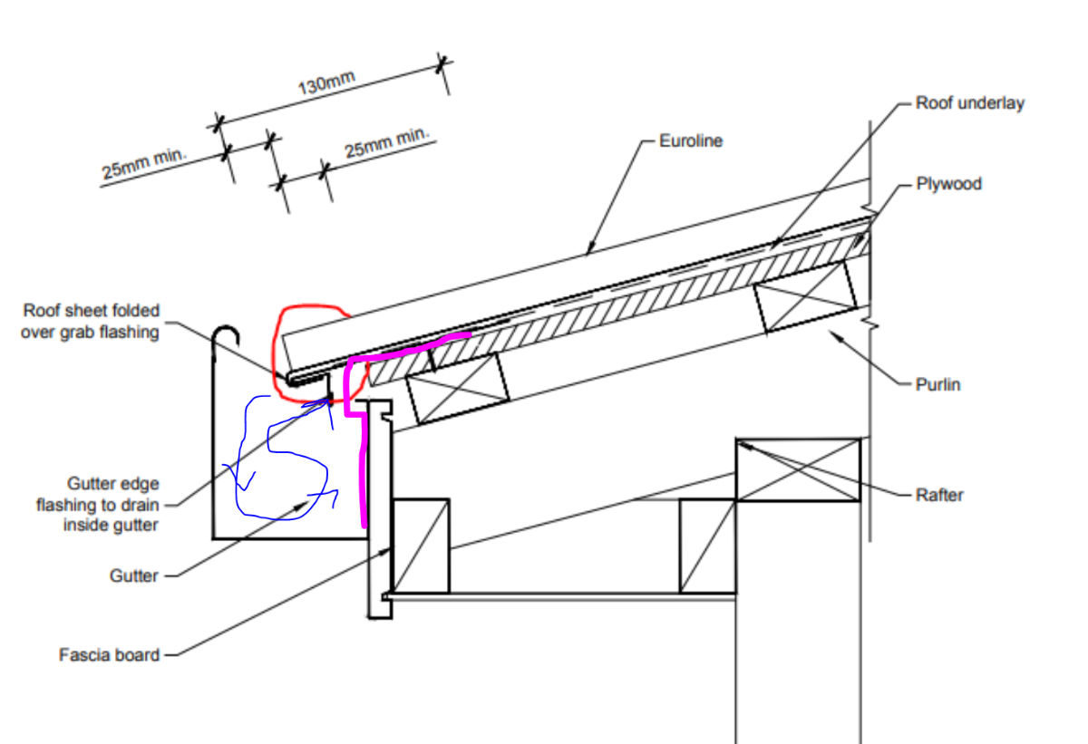

patches Posted October 4, 2021 Share 8 hours ago, Capricorn said: lekker! But in which direction is that rain water going to flow? Is that toward your property? is there a gutter on the downslope side? Free water for my neighbour! He can thank me later! ???? Just kidding, whilst the roof does slope at a 6.5deg grade towards his driveway, it is still all on my side of the fence. I do have a plan to fabri-cobble a catchment system. A gutter would have to have a very slim profile due to the limited space, so my other 2 plans are: The first idea is a C-shaped channel made from some split pvc piping which I slide/clip on to the end of the sheeting. The troughs in the roof sheeting should allot the water to flow into the split pipe. That pipe can then be perforated to drop water into a gutter below with a fall to one side or the other. My second idea is similar, but in stead of a C-shaped catcher, I have a vertical sheet of acrylic/perspex as a back-stop for the water. That then allows the water to fall down into a gutter. A concept all boys that went to public schools will be familiar with Either way though, my neighbor has a pebble bed on the other side of the fence, and this 3x 1.8m roof at a gentle graded roof shouldn't Vic falls. And if it's raining THAT hard, the water off this little dakkie will be the least of his worries, hahaha Capricorn 1 Link to comment Share on other sites More sharing options...

Hairy Posted October 5, 2021 Share 8 hours ago, patches said: Free water for my neighbour! He can thank me later! ???? Just kidding, whilst the roof does slope at a 6.5deg grade towards his driveway, it is still all on my side of the fence. I do have a plan to fabri-cobble a catchment system. A gutter would have to have a very slim profile due to the limited space, so my other 2 plans are: The first idea is a C-shaped channel made from some split pvc piping which I slide/clip on to the end of the sheeting. The troughs in the roof sheeting should allot the water to flow into the split pipe. That pipe can then be perforated to drop water into a gutter below with a fall to one side or the other. My second idea is similar, but in stead of a C-shaped catcher, I have a vertical sheet of acrylic/perspex as a back-stop for the water. That then allows the water to fall down into a gutter. A concept all boys that went to public schools will be familiar with Either way though, my neighbor has a pebble bed on the other side of the fence, and this 3x 1.8m roof at a gentle graded roof shouldn't Vic falls. And if it's raining THAT hard, the water off this little dakkie will be the least of his worries, hahaha Just check with the detail that you also bring some flashing up under the sheeting to prevent wind blown water or a blocked downpipe water from coming in Link to comment Share on other sites More sharing options...
