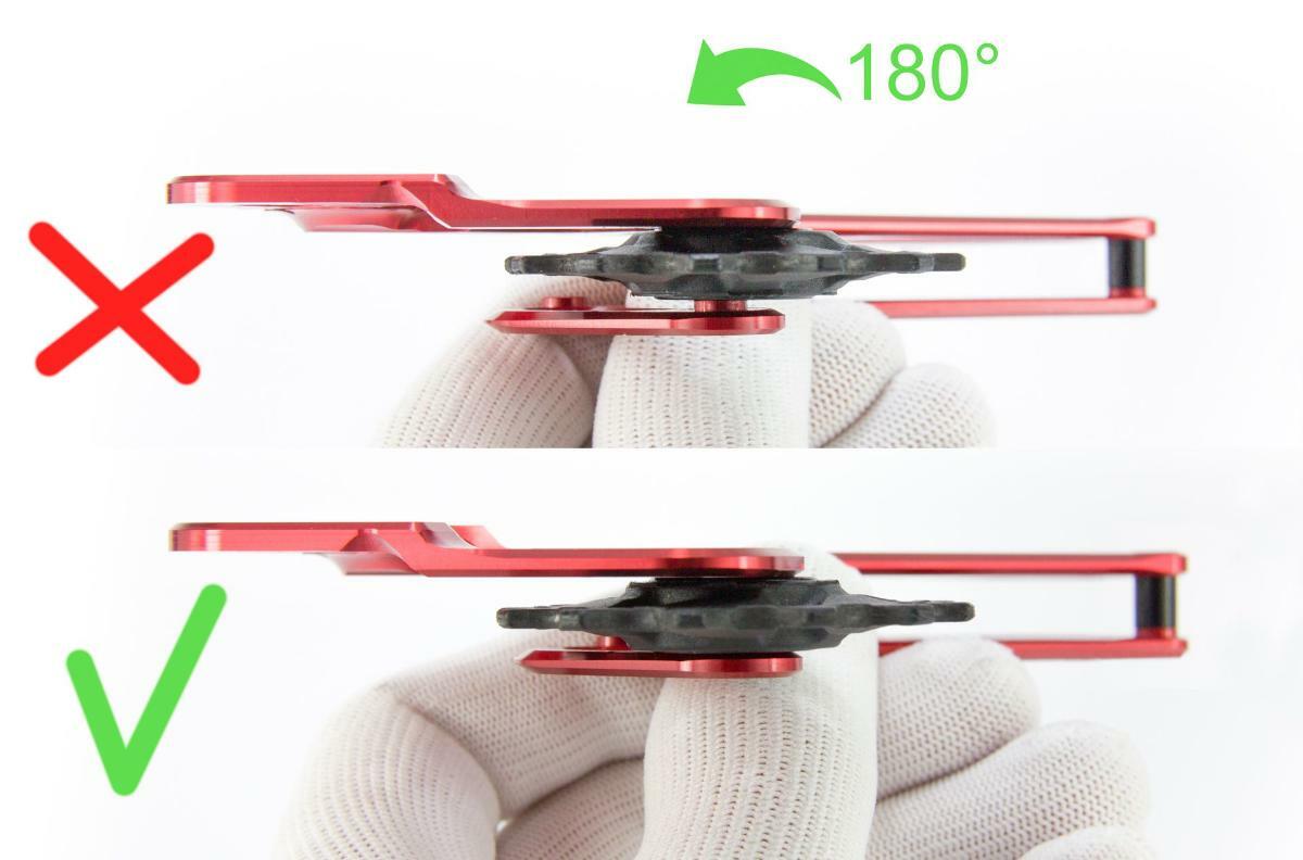

On the top pulley - diagram below is what I'm talking about, sounds like you may have one of the spacers on backwards which could well be causing your issue.garbaruk-rd-cage-installation-sram-11-12-speed-step-7.jpg.c057f2f5b5a4360230ef119997c96235.jpg

Here you can see the upper pulley is spaced towards the outside (sorry about the mess, the new chain was freshly waxed waiting for it's day)
