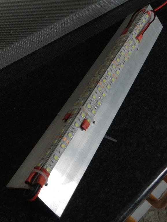

ChrisF Posted June 1, 2021 Share On 2/20/2020 at 12:36 PM, Eddy Gordo said: Off grid and grid tied is very expensive. I have opted for separate lights which run off a battery. I want to ad a solar panel to this, and run my fish tanks. The fridge and freezer I am considering a UPS. I think thats around 10k for the ups. Solar panel would probably cost around 2k or more depending how much batteries I am gonna run. Solar wiring is around R350 for 20m. I reckon I am in a ball park number of 15 to 20k. I wont incorporate into the grid with the lights. My idea is basic lights for the house. Should we have visitors or a family gathering then we can use eskom lighting. I am happy to leave the fridge, freezer, tv and computer on eskom as well. I have a laptop and wifey has a tablet. We can charge these in our cars or off the battery pack I have for the lights. It is a gel something battery. Been going for a couple of years now. We went this route, 6 years ago. Initial planning was purely for emergency lighting .... ended up installing 12V lightings throughout. 100W panel charge a 105A.h deep cycle battery. We now only use the bathroom light to activate the extract fan. I later added a car radio to this .... light, sound and you dont even care about a load shed. I use this 12V system to charge the cycling computers, bike lights, phones, GoPro batteries, etc Next step was a gas stove. Yet another step was a solar geyser. Here we opted for the Geyserwise dual element system. PV panels heat the water via DC element. The Geyserwise timer allows you to set minimum temperatures for specific times, so you know you will have a hot shower before work. I logged the Eskom energy to the geyser on this system for a year. It WORKS !! Payback was only 3 years. Pool pump is a Grundfoss pump, which can run off PV or Eskom. It senses the input and does the rest internally. Nice system, but at 20k I doubt it will reach pay back. So we loose the following during a loadshed: . Fridge . Washing machine . Tv, desktop, wifi ... . Garage door opener I then got a UPS for the tv, desktop, wifi ... came in VERY handy during lockdown !! Been contemplating the next step for a while .... cost vs payback just does not add up .... a decent inverter on the lights battery can operate the garage door, which I needed once in 12 years to get out, parked outside a few times though. This inverter could then be used to charge the ebike batteries ... ???? Clearly this was a long term project. Looking back over about 6 years of this system it works very well for us, for very minimal cost. Eddy Gordo 1 Link to comment Share on other sites More sharing options...
ChrisF Posted June 1, 2021 Share On 3/2/2020 at 2:19 PM, madbradd said: I was thinking of something like this and putting LED light strips behind curtain rails (or similar) with a local switch behind the curtain. I replaced the old incandescent 3x-spotlights, with these lights using 2x energy efficient bulbs. Then proceeded to wire the LED strip "into" the unit. I dont like the look of open LED strips. (okay, since then you can get some nice units to hide the LED strips) Starring into the light you will notice it is "different" to standard bulbs. But as I sit and type this post, the light "spread" and light levels in the room is the same as it would be with the eskom lights. The lights are controlled via a four-button alarm remote system. In this pic I am programming the remotes for the four light zones of the house. Another four-button system is used in the braai and garage. The remotes are velcroed above the eskom light switches. This is the only visual sign in the house. Off course the remotes makes "two-way switching" a breeze. While I was playing .... I added a motion sensor and built in timer to activate an LED strip in the garage. So walking to the car in the morning, or putting something in the bin, no need to switch lights on. AND no way to forget to switch off lights in the garage. Rocket-Boy and madbradd 2 Link to comment Share on other sites More sharing options...

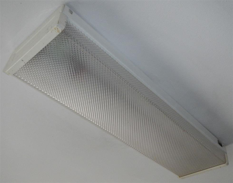

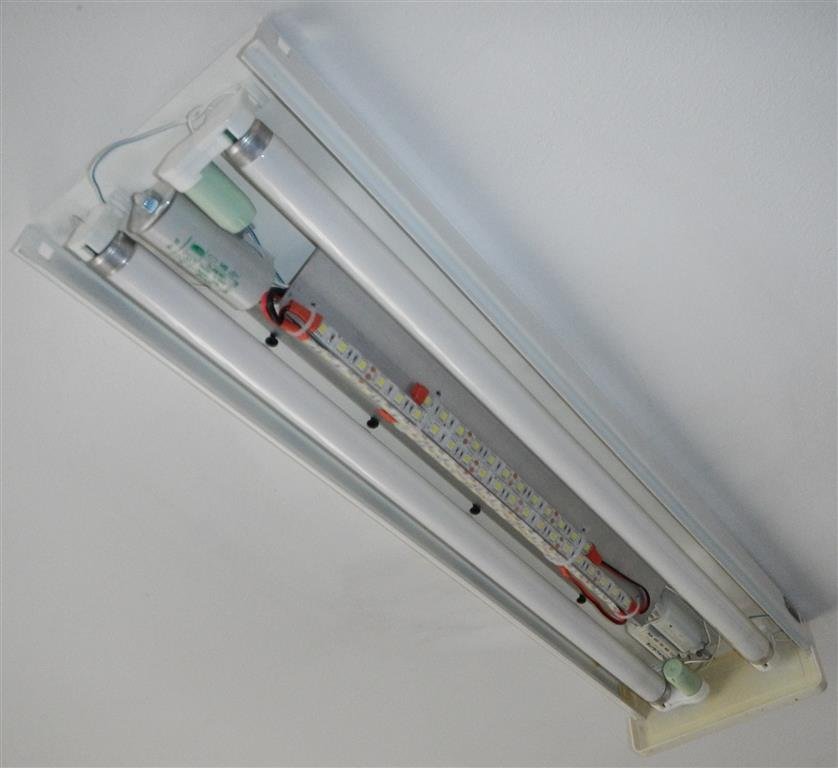

ChrisF Posted June 2, 2021 Share 10 hours ago, ouzo said: I guess this is a good place to pose the question. In my kitchen I have regular florescent tube light on the ceiling, how easy is it to convert this to using LED tubes ? Karman is 100% correct in how to switch the old tube system over to the new LED tube system. For BACP-UP purposes I went this route - This was done for "load shedding back-up" .... works so well that we have not used the eskom tubes in 6 years Karman de Lange, bertusras and mazambaan 3 Link to comment Share on other sites More sharing options...
