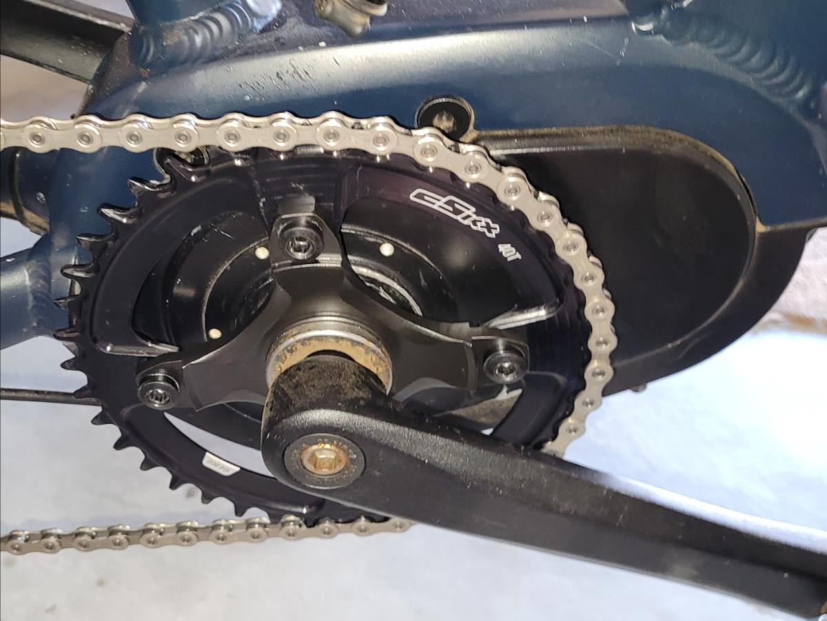

12 minutes ago, droo said:
Then I'd guess they probably snapped. Alu bolts or steel?
Not sure.  Will check if I have still spares of these bolts
Which do you recommend ?  Steel or Alu ?
  • Replies 1.1k
For an ebike, definitely steel.

1 hour ago, Jewbacca said:
I was about to say, over torqued alu bolts
They snap all the time.
@ChrisF steel bolts every day of every week, even the 29th of Feb
Was installed at 6 N.m 👍
Uhmmm .... what is the correct torque for these ... 🤦‍♂️
5 hours ago, ChrisF said:
Nope.  SILENCE ....
When the chain starts to creak I stop and lube.  Okay, that applies to the MTB on a long ride ... but you get the idea.  I detest a noisy bike !
There were no:
- sounds
- vibrations
- funny gear shifts
Simply no alert as to the pending "fun" .....
The last 15 km was from Malanshoogte, then through all the back streets of Durbanville (LOTS of stop start), out on Wellington, and then via Brackenfell Boulevard (again a lot of stop starts).  Turning from BRackenfell Boulevard onto Frans Conradie the "fun" started.
When I fitted the new ring last year I got new ring bolts.  Those with allen key on both sides.  I always use blue locktight.
Nope, this one has me stumped ....
O-well, perfect time for the bike to go to Mark for some TLC and a good check up before the Argus.  Rather now, than up Smitswinkel ....
Those Bolts are Easily Over Tightened . Locktite does Not Help in this case .
Hi Droo
I popped in at Mark.  The bolts were aluminium.
He only has aluminium bolts on the shelf.
Any idea where I can buy a set (or two) of steel ring bolts ?
Okay .... when all else fails ..... go read the Parktool Big Blue Book.  :ph34r:
different torque settings for Alu and Steel.
Pretty wide range between 5 to 10 N.m.  My 6N.m would thus have been on the low end, rather than over-torqued.
Though steel bolts seems to be the safer option for e.bikes .... now just to track it down ...
And yes, Parktool do recommend a "thread locker", ie locktight.

My uneducated guess is that you had one weak one, when it went the extra force took the others out.
I call bollocks.
Chris didn't tighten them properly. They came lose. Put new ones and go ride that Argus like a winner.
Dont over think it chris, you'll be fine by replacing them
