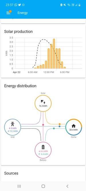

For the RPi and inverter, there’s a PCB that can be installed (Sunsynk) and connected to the WiFi.
It then allows integration to the home-assistant app. There’s a lot to read up on, on the interwebs.
