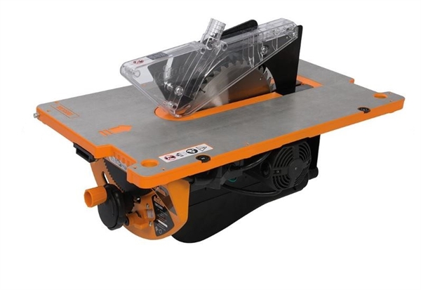

If you don't already have a decent large circular saw laying around, quality plywood (you don't want to use anything less than birch ply - our other local pine- or shutter ply is crap) and other materials, building a decent saw like that will probably cost at least twice as what a cheap entry level saw would, and then you're still left with the other big factor - can you successfully and accurately make such a saw that will offer the precision you require.
The only time I'd consider a home built table saw if I've limited space and building it into a workbench of some sorts. And then I'd opt for one of these Triton modules if you can still find one around;
This one is also not too bad for occasional diy jobs;
https://www.paoson.com/en/shop-woodworking-homemade-tools-furniture-plans/49-homemade-portable-workshop-plans.html
