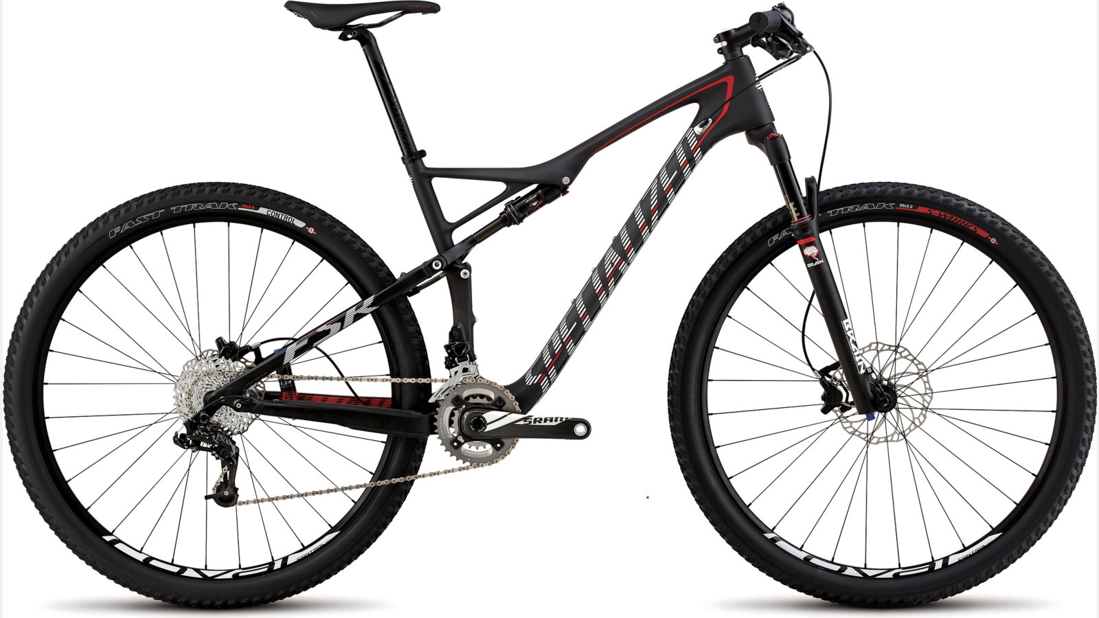

Paintwork reminds me of a 2015 epic....
Epic Elite Carbon 29 | Satin Carbon/White/Red
Dare I say that Giant are 6 years behind Spez??? (It's a joke......)
This and the Giant are no where near simular even
This has a pivot at the rear axel and the new Giant does not
